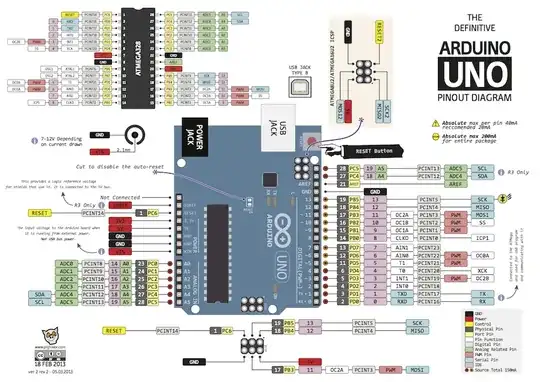

Assumption: As the specific Arduino model has not been specified, using the Arduino Uno to illustrate this answer. The rationale applies identically to the other Arduinos, for their respective pin-outs and microcontroller operating voltages.
Please refer to this pin-out diagram for the Arduino Uno: (source)
Arduino Uno pin-out
  • As can be seen, Pin 10 and 11 are both standard GPIO pins.
  • Any GPIO can not output a voltage higher than the microcontroller's supply voltage (VCC), in the Arduino. For the Uno VCC is 5 Volts.
  • Any GPIO pin can withstand input voltage up to VCC and a slight bit higher (5.5 Volts is tolerated as standard)
  • Also, when any Arduino GPIO is set to input, it is in a high impedance state, thus making it impossible to pass enough current into it for the voltages involved, for any damage to occur.
  • Thus, shorting pins 10 and 11 can not cause any damage to either pin, in the circumstances reported in the question.
