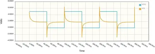

Here the input signal, a 5V/0V square is blue, the unnattenuated, differentiated signal at X is in orange:

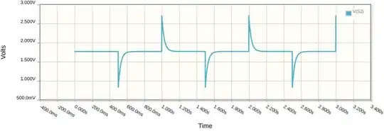

This is the potential at S2:
Simply choose R5 for an appropriate level of attenuation.
It might be better for you to adjust the bias potential at S2 to be right in the middle of the comparator's acceptable input voltage range. From the datasheet, the range seems to be between 0.5V above the lower supply, and 2V short of the positive supply:
$$ V_{S2(DC)} = \frac{(0V + 0.5V) + (5V - 2V)}{2} = +1.75V $$
Modify R1 and R2 (and of course Rx1 and Ry2 to match) to obtain about +1.75V bias. I've done that here, and also increased R5 for more attenuation:
simulate this circuit
As you can see, the signal never exceeds the permissible range of input potentials, +0.5V to +3.0V, and is also centered within that range.
