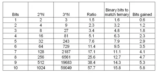

The table shows the number of states using N pins of binary and ternary encoding,
The ratio between the two
The number of binary bits you'd need to get as many states as ternary gives (round that up ) and
The effective number of bits you gain (round that up too).
