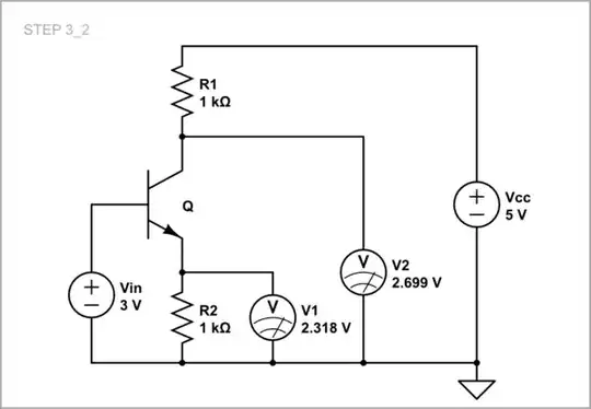

Practical phase splitter
It remains only to replace the variable resistor with a transistor Q that will act as a voltage-controlled "resistor".
simulate this circuit
Now the voltage drops across R1 and R2 depend almost linearly on the input voltage.

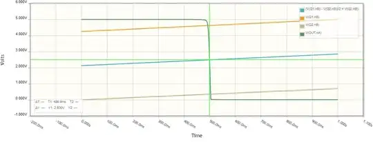

Now let's see how the output voltage changes.
STEP 4_2a
At the moment of transition, the current is significantly reduced.
STEP 4_2b
Why the HIGH output voltage is low
A bunch of problems lead to this:
  • A voltage drop is lost in the resistor R1
  • Another voltage drop is lost in the resistor R3
  • 0.7 V is lost in the emitter follower Q1
  • Another 0.7 V is lost in the diode D
You can see it in the graph below.
STEP 4_2c
