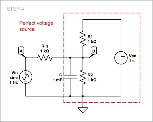

Decoupling capacitor
In this application, the capacitor should break the connection between the two points (in the sense that there is no signal transfer between the two points). But it cannot do so in series (an inductor can do it); therefore we connect it in parallel to the "receiver" point (i.e. between the point and ground, as a shunt).
In this experiment, the input source Vin is imperfect (it has an internal resistance Rin = 1 kohm). Its voltage is equal to the voltage of the right source which is improved through the capacitor C in parallel.
simulate this circuit
When the power is turned on at time 1 s, the capacitor is charged as above to 5V (AC Vin = 0 V).
STEP 4
The output voltage of the imperfect voltage source (voltage divider) is fixed by the capacitor and it behaves as a perfect voltage source.
As a result, the voltage of point B does not change when the input voltage at point A varies as if the connection between them is broken by the capacitor...
STEP 5
... hence the name "decoupling capacitor". Since this name is somewhat misleading, more appropriate names such as "bypass capacitor" are also used. Note that here we suppose the input voltage source has some internal resistance.
