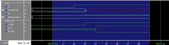

With the right simulator, the delta delays can actually be visualised. ISim doesn't it do it, but in e.i. ModelSim, you can enable delta expansion around the clock edges. Below is an example screenshot from a buggy 3rd-party IP that I trouble-shooted.
Delta delay expansion in ModelSim
c is the clock signal, and the +1 etc. are the delta cycles, visualized as time.
If a design is simulated where both the simulation and the design is truly ideal and synchronous, with no delays simulated, you can, in principle, view all signal changes on a specific clock flank as happening slightly after that clock flank. In your example, therefore, at 205 ns, data_write = 0000... is what is being captured. Some other logic in the first unit is changing the signal data_write to 0001... on the same flank, and that signal appears on data_write slightly after the clock flank. This "slightly after" would be one or several simulation deltas in an ideal simulation (your example) (not visible in ISim, but in e.g. ModelSim with delta expansion), or some ps/ns later in the real world.
