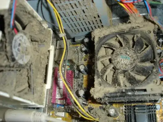

Dust or other crud accumulating on the device, acting as insulation keeping it from cooling off as well as it needs to.

This is Air Contamination Fault:
