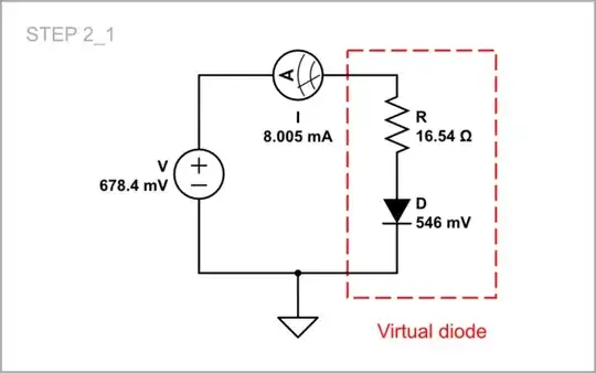

But the "ideal" diode was something quite abstract, and maybe that is why others presented the diode to me as an "ideal" voltage source and a low resistance resistor in series. This brought me new frustrations at the time because I was unsuccessfully trying to power a small radio receiver with a few diodes in series:-) But let's try it now with the help of CircuitLab.
simulate this circuit
The IV curve should look like this…
Diode IV curve I = f(V)_3_2
... but here is what the graph is. Obviously, this is not a very good model for beginners...
As you can see, when V1 < V2, the "diode voltage source" can supply the input device:-)

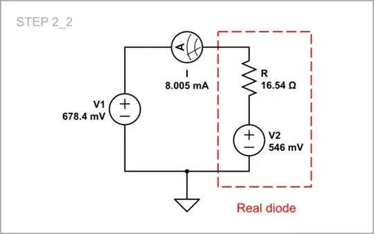

Dynamic resistor
I understood what the diode actually did when I imagined it as a varying, "dynamic" resistor which varies its resistance so as to maintain a relatively constant voltage. Let's see what it is for three typical points on the curve.
Point 0: VF = 425 mV; IF = 0 mA, R = infinite.
Diode IV curve I = f(V)_5
Point 1: VF = 644.3 mV, IF = 4 mA, R = 161.1 ohm.
Point 2: VF = 678.4 mV, IF = 8 mA, R = 84.8 ohm.
As we can see as the voltage increases the resistance decreases and the IV curve is almost vertical.
Diode IV curve I = f(V)_6
Thus, if you continuously adjust the resistance for each value of the input voltage, you will mimic the real diode. If you hide in a box together with the resistor, the outside observer will think that there is a diode inside :-)

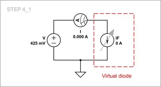

Current "source"
We can even make (model) a diode by a "dynamic" current source changing its current in the same way when the voltage varies. Here are the arrangements for the three typical points on the curve.
Point 0: VF = 425 mV; IF = 0 mA.
Point 1: VF = 644.3 mV, IF = 4 mA.
Point 2: VF = 678.4 mV, IF = 8 mA.
