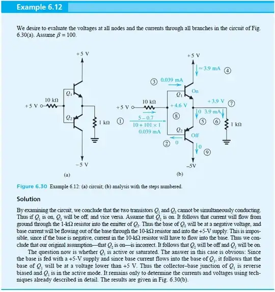

It might be better to use an NPN/PNP pair as emitter followers with only about 0.7 V to the rails. Actually with a 100 ohm load the output is essentially zero.

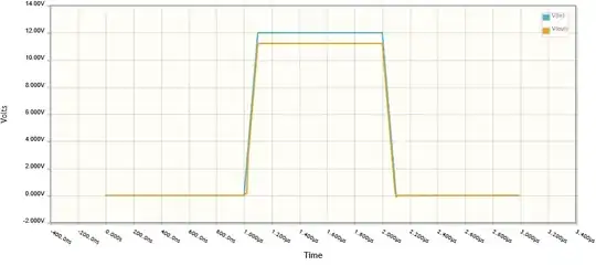

This is a 1 us pulse with 100 ns rise and fall times, and the output very nearly follows the input. Drive into a MOSFET gate might show some delay.

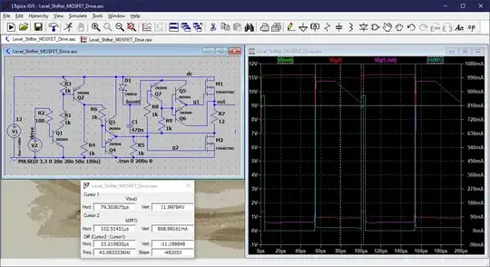

Here is a simulation of a complete level shifter circuit driving an NMOS half-bridge from a 3.3 V 10 kHz PWM signal and a 12 V power supply. It does not incorporate crossover control. This would probably be best implemented with a separate drive for the high and low side MOSFETs.
Level Shifter MOSFET
