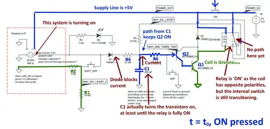

Diagram of my circuit enter image description here
