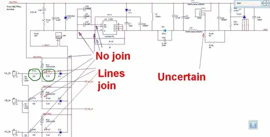

Suppose I have a schematics such as the below. I want to fast simulate it: see how the current flow and put my mouse to different positions to see how things work. Since there are many different ways to do the schematics, this requires to break the problem into human-solvable parts and computer-solvable parts -- some aspects about feature-extraction here.
Is there any feature-extraction-canabled software with OCR support and shape-extraction that would turn schematics such as the below into a simulation?

No, nothing like that exists. You'll need to reenter your schematic manually in a simulator tool, such as the free online https://www.circuitlab.com/ (which is actually integrated with this website).
Such a tool would be difficult to create, and impossible to realistically support considering the multitude of ways even a single IC could be represented. The tool would not only need to be able to recognize each part, but also find its electrical characteristics from somewhere. Other issues include determining what labels are associated with each part (such as the "1M" on R1), disambiguating various symbols (your potentiometer looks an awful lot like a resistor and upside-down ground)... I could go on.
In short, it's unrealistic.

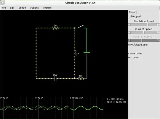

As others mentioned you have to draw your schematic but Falstad's Circut Simulator is visually close to what you want. Although It's not capable as other simulation softwares it still contains most of the basic components which may help you understand working principles of simple circuits.
It shows you current current on all nodes and by right clicking to a node and selecting "View in Scope" you can see voltage change on this node.
Also being java it's cross-platform and can work from web-browser.
