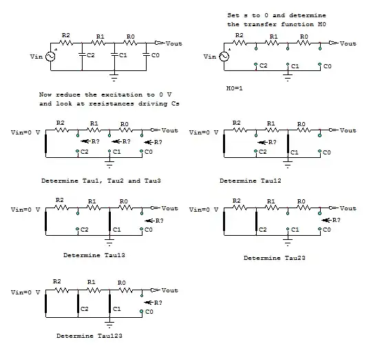

If you want to determine this transfer function seamlessly, the best is to resort to the fast analytical circuits techniques or FACTs. A tutorial introduction is proposed in my APEC 2016 seminar. The principle is to look at the time constants of the circuit in different conditions, when the excitation (\$V_{in}\$) is reduced to 0 V or replaced by a short circuit in the schematic. Then, you "look" at the resistance offered by each of the energy-storing elements (the capacitors in this example) when the rest of the elements are placed in their dc or high-frequency state. Look at the below sketch:
First, you look at the transfer function \$H_0\$ for \$s=0\$: open all the caps and find that \$H_0=1\$. Then, determine by inspection - meaning, just observe the schematic - the resistance offered by each capacitor's connecting terminals when the other caps are set to their dc state (infinite impedance or removed from the circuit).
Now reduce the excitation to 0 V and replace the source by a wire in the schematic. For \$C_1\$, the resistance you "see" is the series connection of \$R_1\$ and \$R_2\$ so the first time constant is \$\tau_1=C_1(R_1+R_2)\$. For \$\tau_2\$, the resistance is \$R_2\$ then \$\tau_2=C_2R_2\$. And for \$\tau_3\$, the resistance is \$R_1+R_2+R_0\$ then \$\tau_3=C_0(R_1+R_2+R_0)\$. Adding these time constants forms the first denominator coefficient \$b_1=\tau_1+\tau_2+\tau_3\$. 1 mn to obtain this result without a calculation, just inspection.
For the second term, \$b_2\$, we will look at \$\tau_{12}\$, \$\tau_{13}\$ and \$\tau_{23}\$. This notation simply means that for \$\tau_{12}\$, you "look" at the resistance driving \$C_2\$ while \$C_1\$ is set in its high-frequency state (a short circuit). For instance, looking at the above sketch, you see that \$\tau_{12}=C_2(R_1||R_2)\$. Continue and form \$b_2=\tau_1\tau_{12}+\tau_1\tau_{13}+\tau_2\tau_{23}\$.
For the final term, \$b_3\$, determine \$\tau_{123}\$: look at the resistance from \$C_0\$ terminals while \$C_1\$ and \$C_2\$ are set in their high-frequency state (a short circuit). Then, assemble \$b_3=\tau_1\tau_{12}\tau_{123}\$. This is it, you have your denominator \$D(s)=1+sb_1+s^2b_2+s^3b_3\$ and the transfer function is immediate and equal to
\$H(s)=H_0\frac{1}{1+sb_1+s^2b_2+s^3b_3}\$.
with:
\$b_1=R_1C_1+R_2(C_1+C_2)+C_0(R_1+R_2+R_0)\$ \$b_2=C_1(R_1+R_2)(C_2(R_1||R_2)+R_0C_0)+R_2C_2C_0(R_1+R_0)\$ \$b_3=C_1C_2C_0R_1R_2R_0\$
If all resistors and capacitor share a common value, as in your schematic, the final result is given below:
The ac response appears below and you can see that both brute-force transfer function and the one I obtained by inspection are rigorously equivalent in magnitude and phase:
As you can see with the FACTs, I did not write a single line of algebra and chopped the original schematic in a series of small sketches individually observed. You can now expand the expression I derived by replacing \$s\$ by \$j\omega\$ and determine the value of \$\omega\$ for which the imaginary part cancels.
