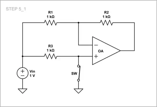

This configuration is extremely interesting and basic for a class of analog circuits. That is why I prepared this story illustrated by numerous experiments.
Basic idea
It is a little "algebraic":
First we decrease the quantity X with a varying coefficient K (0 ÷ 1), then we increase it twice and subtract from it the input quantity X:
X -> K.X -> 2K.X -> 2K.X - X -> (2K - 1).X
Thus, for three typical values ​​of k (0, 0.5 and 1), we obtain a gain of -1 (inverter), 0 ("zeroer") and 1 (follower).
Common-mode differential amplifier...
We can see this idea in the classic 4-resistor op-amp differential amplifier when two equal input voltages Vin1 = Vin2 are applied (the so-called "common mode")...
... with a common input voltage source...
... by replacing the two input sources with only one common source Vin; hence the name "common". Here this situation is undesirable and must be suppressed (the output voltage must be zero). Therefore, K = 0.5 is chosen for the circuit to work as a "zeroer". Thus we get the famous circuit with four identical resistors. For simplicity, in the schematic below, I have used the favorite resistance value of 1k and voltage 1V.

R4 -> switch. If we replace R4 with a switch, the circuit will work in its two extreme states.
Odd voltage follower (gain 1)
SW open. When the switch is open a very strange configuration is obtained. The non-inverting input is connected through R3 to the input source and the left terminal of R1. The inverting input is connected to the right terminal of R1. Thus the op-amp is forced to maintain zero voltage across R1. For this purpose, it keeps its output voltage equal to the input voltage, i.e. it acts as a (really, quite odd) voltage follower.
simulate this circuit
There are two unique phenomena in this arrangement:
  • The voltages at all points are the same
  • No currents flow
So this is an equipotential and no current circuit.
In the picture below, the two graphs (of the input and output voltage) are on top of each other and only the upper one (of the output voltage) is visible. This will also happen in other pictures below.
STEP 4_1
R3 -> piece of wire. Since practically no current flows through R3, it can be replaced with a piece of wire and the circuit simplified. But it looks no less strange than before. It is an "inverting amplifier" that keeps the voltage on its virtual "ground" equal to the input voltage... and as a result it has become a follower.
Graphical results are exactly the same and confirm this.

Classic inverting amplifier (gain -1)
SW closed. The non-inverting input is connected through to ground. R3 is in parallel with the input source and does not play any role. So the circuit is an inverting amplifier...
... as you can see from the graphs.
STEP 5_1
We can remove R3...
... and it does not affect the graphs.
