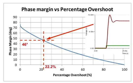

The percentage overshoot is given by ( (4.2-3.3)/3.3)*100 = 27% .
This will give a PM of almost 40Deg.
Please correct me if I am wrong.

To get a rough estimate of the phase margin using a transient simulation, you can "whack" the output of the buck converter with a very fast load step, i.e. going from 0A to 1A within 1µs (and vice-versa). The amount of ringing you observe at the output is directly correlated to the phase margin. It'll be worst without a load resistor connected to the buck converter.
If the converter regains regulation without exhibiting any ringing after this load step, it's stable and has a phase margin of 50° or more. Check out this answer for a graph showing exemplary step responses for different phase margins. I've found that this method of determining the stability of switching converters in LTSpice is sufficient for most of my designs.

Regarding your second question, I'd be a little nervous about a system that has less than 10dB gain margin. 10dB is the absolute minimum I aim for, and even that means that the system might become unstable if its gain changes by more than a factor of 3. Additionally, 30° phase margin will cause significant ringing as seen in the answer I linked above; I wouldn't go below 45°.
