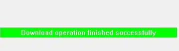

  3. Using the STMFlashLoader to flash the Bootloader (found on GitHub) enter image description here
    also put the Boot0 High, and the Boot1 low. (like mentioned in the Datasheet Pattern1: enter image description here
  4. Getting to the next window (with the traficlight) --> saying Flash size is 64KB.enter image description here
  5. Then choosing the STM32F1_Med-density_64K version of the Target
  6. Still following the tutorials, I choose Download to device and selecting the Download from file the binary-file: generic_boot20_pc13.bin (downloaded from GitHub)
  7. Its staring downloading and it also finished successfully
