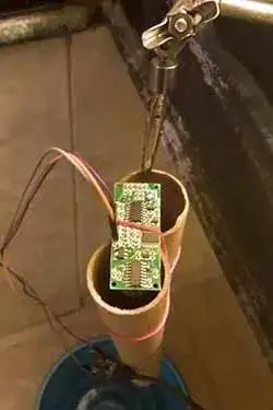

[Edit] I can't believe I'm doing this: Photos of my experiment, in my bathroom, on request from the comments!
The enhanced version now has two cardboard tubes, for TX and RX respectively - Even better precision and tissue paper no longer needed. Arrangement is held together by rubber-bands, because the Engineering-approved duct tape isn't handy. It's hanging from the alligator clip of a Helping Hand soldering stand.
Circuit board on top is the ultrasonic sensor, circuit board dangling from it is an Arduino Nano clone. Blue circular object at bottom of image is the official depth sensing chamber i.e. my bucket.
The TX and RX fit neatly centered, one in each cardboard tube.
At left edge is the Engineering Department's official representative, or at least the fingertips of said person, me.
This is how the set-up looks from the side, in case that helps visualize the arrangement better.
I hope this show-and-tell was useful.

  • @Anindo, amazing coincidence really ! I think I can visualize your modifications, and by idea of collimator was something similar, though my apprehensions were, what prevents the collimating-tube itself, from being the object that reflects the sound waves ? Perhaps if you could share a few photographs of your modification, it might help with the understanding. – bdutta74 Apr 19 '13 at 05:55

  • Thanks @Anindo, that answers my question to David. Ah, and this is perhaps the stupid-question-of-the-day, but let me shamelessly ask anyway - is it right that your cardboard tube is with the audio Tx transducer aligned to the tube's central axis, with the Rx transducer being outside the tube ? Or is the Rx also inside the tube ? – bdutta74 Apr 19 '13 at 06:10
  • @icarus74 Photos added, and with highly technical descriptions too! – Anindo Ghosh Apr 19 '13 at 06:44
  • Awesome use of cardboard tube binoculars :-) ! Need to borrow some from my son. Thanks a ton, for the pics, and the "highly technical description". Thoroughly enjoyed. – bdutta74 Apr 19 '13 at 06:55
