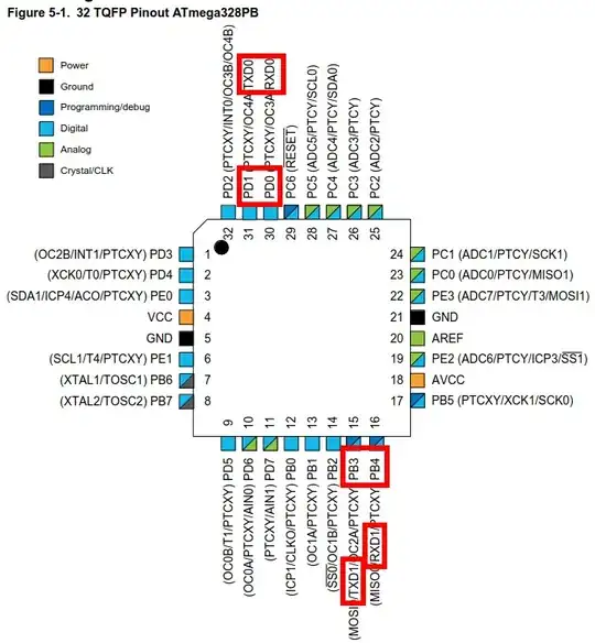

The ATMega328P has only one hardware USART, hence you don't have to tell it anything. The USART is connected to PD0 (RXD) and PD1 (TXD) and you can't change it.
If you want to do serial on another pin, you can use "software serial" which drives whichever pin you want. There re many libraries for this, and it's not so hard to write a custom one if you need it. Usually your bit rate is somewhat limited, and you'll have potentially unwanted blocking or use interrupts.
The datasheet is written that way because some of the CPUs have more USARTs. For example the ATMega328PB has two USARTs and can use PB3 and PB4 as TXD1 and RXD1, with PD0 and PD1 being renamed RXD0 and TXD0. Libraries for programming this will have some way to say which you want.
From the ATMega 328pB datasheet
