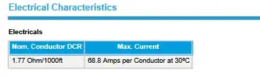

Where do you find that a 12 AWG wire is rated for just 30A?
That may be true for standard, PVC-insulated wire used for home electrical systems.
The ampacity of a wire doesn't depend solely on wire dimensions (cross-section) and construction, but also on the characteristics of the insulator and the environment in which it is deployed.
Unless you have a datasheet that says that a specific wire can carry at most 30A, your assumption may be wrong. For example, silicone-insulated copper wire can withstand higher temperatures for the same cross-sectional area, so their ampacity will be higher, all other factors being the same.
Just an example of your ampacity estimation being wrong in general, here is a datasheet of a high-temperature appliance wire, 12AWG (just the first I happened to find):
This is a relevant excerpt from further down in the page:
Note in the header the insulating material il not common PVC, but EPDM (Ethylene Propylene Diene Monomer).
As you can see, it is rated for almost 70A at 30°C. That's not your 100A, but it's getting close, and it is in free air, i.e. with just natural convection acting on it.
As Marla already pointed out in her answer, forced air-flow conditions could well allow higher ampacities.
