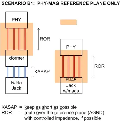

On an at least four-layer PCB, it is simple to organize the corresponding reference planes and there are two sub-scenarios here:
  • 1) If you (can) organize AGND reference plane only, than only phy-mag pairs can be traced impedance matched, therefore you must keep the mag-rj45 distance as short as possible. (Keeping the lengths matched is also mandatory here.)
  • 2) If you (can) organize both AGND between phy-mag traces and (let's call it so) MGND between mag-rj45 traces, than you can trace all the pairs impedance&lengths matched. But you must be aware that each mag-rj45 path must have its separate reference plane, rather than AGND that can be shared.
    Some tips on how to do MGND is shown below.

IMO, Scenario B1 is preferred, because tracing many pairs (including many pairs of many phys) with respect to one reference is simpler than what is needed to do in other cases.
