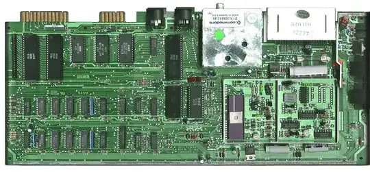

Generally when through hole ICs were popular you would be making one of two types of circuits, a large circuit requiring a lot of gates where the majority of gates in the standard packages would get used, or a circuit with only a couple of gates where you didn't really care about the size of the board, even with unused gates it still wouldn't be all that large. Back in those days it wasn't unusual to see boards with chips spread apart pretty far, unless you were building something to go to space size wasn't as much an concern as it is today. Take for instance this 1980's vintage board: commodore 64 board Obviously they weren't trying to pack things in very tight.
Photo from https://en.wikipedia.org/wiki/Commodore_64

    It wasn't so much that size wasn't a concern -- it's that multi-layer boards weren't as common, and traces take space (even 2-layer plated-through boards were high tech in the late 70's, early 80's). Just look at the amount of board space taken up by traces in your example above. I'm guessing that it's a two-layer board, and that jamming more circuitry onto it would involve a lot of extra layout time. – TimWescott Mar 22 '23 at 23:21
    @TimWescott: Also, these boards were [laid out by hand](https://www.pcblibraries.com/forum/pcb-design-in-the-1970s_topic2333.html) (pencil, paper, stickers and tape) at that time. – Dennis Williamson Mar 23 '23 at 15:53
    Actually, that one looks like it was laid out in a CAD program, at least to me. Hand-laid boards tend to have traces that look more organic. – TimWescott Mar 23 '23 at 22:16
  • I'm having a hard time remembering when we got our first schematic capture tools. I think is was 1990, Tek CAE, IIRC. I thought our drafting department, which did the actual layout and routing, had CAD tools before that. So it's very probably something from the mid 80's would have been laid out and routed with a CAD tool. – SteveSh Mar 24 '23 at 14:01
  • The company I worked for in 85/86 did CAD layout. We would use a large format plotter to plot them on clear film that was sent to the place that made the boards. And you could absolutely pack a double sided board much tighter than in the photo above if you really wanted to. – GodJihyo Mar 24 '23 at 14:33
  • It was probably mid 80's (not 1990 that I stated above) that we got the Tek CAE gear in house, though it wasn't in widespread use. That would be consistent with Tektronix's purchase of CAE Systems in 1985, and then the sell off of that business to Mentor Graphics in 1988. – SteveSh Mar 24 '23 at 15:00

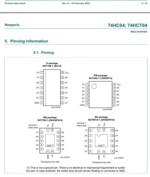

For example, this is an excerpt of the 2012 datasheet of the standard hex inverter chip 74HC04 from Nexperia (NXP at the time):
NXP 74HC04 - 2012
where the DIP14 package was still available. In the 2023 datasheet of the same chip now you find this:
NXP 74HC04 - 2023
The DIP package has disappeared and there are more SMD package options.
