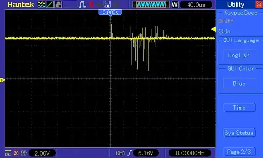

After inspecting the traces between the Raspberry Pico and the MAX7219M seven segment driver IC, I noticed that the clock signal, as well as the +5V are really noisy as you can see here: Noisy clock signal Noisy +5V

Most likely cause is the relay contacts arc and spark if there is no snubber to suppress the inductive kick, not at the relay contacts, nor at the contactor coil drive input.
Also some of the spikes you see may be due to incorrect probing techniques, if you simply have the long crocodile clip lead going to some place far away from what you are measuring with the probe tip.

  • Thank you! I might add a snubber network to see whether EMI decreases. I do regret that I did not place a 3.3V to 5V level shifter between the Pico and the MAX7219. You are right about the probing too, I should place test points next time in addition to a ground plane. – SmileXS4 Mar 21 '23 at 13:45
