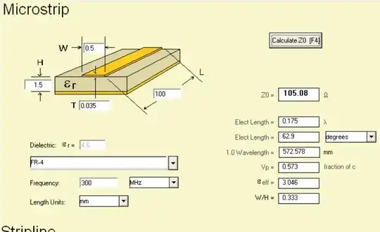

This document mentioned the software AppCAD from Agilent to calculate impedance. Here is the snapshot. My question here is whether this Z0 a complex number or not. enter image description here
If it omits imaginary part, why will we use this software instead of calculator? Does H(Height) and dielectric \$\varepsilon_r\$ matter in this scenario? enter image description here

why will we use this software instead of calculator? Does H(Height) and dielectric \$\epsilon_r\$ matter in this scenario?
The IPC-2141 standard provides a calculation for L and C. Cadence has some good information. I repeat the IPC-2141 microstrip equations to show the need for \$H\$ and \$\epsilon_r\$: $$Z=\frac{87}{\sqrt{\epsilon_r + 1.41}}\text{ln}\left(\frac{5.98H}{0.8W+T}\right)$$ $$C=\frac{0.67(\epsilon_r + 1.41)}{\text{ln}\left(\frac{5.98H}{0.8W+T}\right)}\text{pF/in}$$ $$L=5.071\text{ln}\left(\frac{5.98H}{0.8W+T}\right)$$
Clearly all the parameters including the thickness \$T\$ are needed. Either the software or a hand calculator can be chosen to calculate.

  • @kile I mean that they ignore the loss terms (resistance of the trace and conductance of the dielectric) and thus end up with a lossless line and a purely real Z0. RusselH's answer is more explicit about how the two imaginary compoenents (inductive and capacitive impedance per unit length) cancel to give a real Z0. – The Photon Mar 20 '23 at 20:43
In the design of transmission lines Z0 is usually real, at least the desired Z0 is. That's because, normally the source and load terminations are considered to be real, or have been tuned to be real.
In the provided screen shot the design of a microstrip line is presented, and the height and dielectric constant are elements of the equation for the characteristic impedance such a transmission line, so they are necessary.
If by the "imaginary part" of the transmission line you are referring to the delay of the line that is a function of the length of the line and the speed of light in the line, that is different from the characteristic impedance. The speed of light in a material is also a function of the dielectric constant.

If it omits imaginary part, why will we use this software instead of calculator? Does H(Height) and dielectric εr matter in this scenario?
The calculator helps you establish the inductance and capacitance per metre based on physical distances and, that's pretty useful even though your calculator doesn't actually display those values. \$H\$ and \$\epsilon_r\$ totally matter in this respect.
