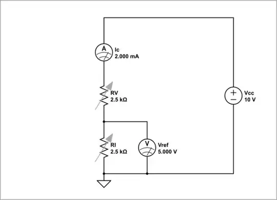

As you can see from the schematic above, RI plays the role of J2, and RV plays the role of J1 from the OP's circuit. Specifically, RI sets the current (by the help of RV), and RV sets the voltage (by the help of RI). In fact, the two resistors form a voltage divider in which the current is set by RV + RI and the voltage is set by RI/(RV + RI).
STEP 4: CircuitLab experiment
The "game". To imitate the behaviour of transistors in this virtuoso experiment:) requires a little more dexterity. The main problem is that the voltage and current are interdependent and require iterative adjustment. For example, suppose you want to increase the input current. You can do it like this: First, open the RI parameters window and begin slightly decreasing the RI resistance looking at the ammeter until it shows the desired current magnitude. Then look at the voltmeter... Ah, the voltage has slightly decreased:-( To increase (restore) it, close the RI window, open the RV parameters window and begin to gradually decrease the RV resistance looking at the voltmeter. Ah, but now the current has slightly increased:-( So repeat the procedure from the beginning... and so on until the voltage becomes 5 V again and the current has the desired value...
Interacting sources. Let's now see how the sources "help" each other. Let you be the voltage source and let me be the current source. When I want to increase the current, I start decreasing RI; but you see that the voltage Vref is decreasing and to increase it you also start decreasing RV. Thus you help me in my desire to reduce the total resistance and increase the current. So, we can conclude:
When the current source decides to set a new current magnitude, it begins changing RI to set a new total resistance RI + RV. As a response, the voltage source begins changing RV to keep the ratio RI/(RI + RV). Eventually they reach equilibrium (there is convergence in this procedure).

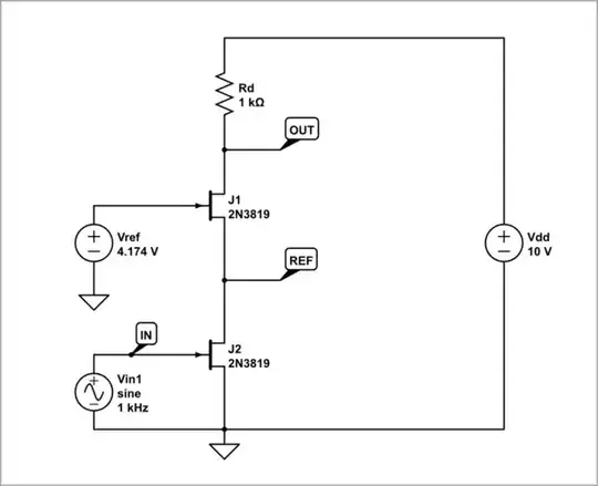

Let's now consider the JFET implementations of this exotic circuit idea to directly help OP in solving their problem.
JFET is a weird device which, contrary to our intuition, is fully on when the input gate-source voltage is zero. In addition, an N-channel JFET requires a negative input voltage to be applied to the gate. This is quite annoying for us because we prefer to use only one power supply, preferably positive.
STEP 7.1: DC circuit (fixed biased). So, to bias an N-channel JFET, we need another but negative voltage source Vin. According to the procedure above, to set 2 mA current through Rd, I have applied -830 mV to J2 gate. Then, to set Vm = 5 V, I had to set Vref = 4.174 V.
simulate this circuit
STEP 7.2: DC circuit (self-biased). Fortunately, there is a solution that allows to avoid the second voltage source. If you insert a resistor Rs between the source and ground, the drain current begins flowing through it and a voltage drop appears across it. This voltage is positive regarding the ground but it appears negative to the gate-source input if the gate is connected through something (input source, resistor...) to ground. So, in the fixed biasing above, the gate is "lowered" below ground (being negative) while here the source is "lifted" (being positive)... but in both cases the gate-source voltage is negative. This negative voltage tries to turn off the transistor; but this decreases the current and voltage, and eventually equilibrium is reached. This mechanism is known as "negative feedback".
In this way, the transistor is "self-biased". You can adjust the bias voltage across Rs by changing the resistance. So, if there are a source resistor, you do not need to apply a negative voltage to the gate since it is already applied.
In the schematic above, I have adjusted Rs = 414 ohm. As a result, 828 mV appear across Rs and the current through Rd is 2 mA again.
STEP 7.3: AC circuit (fixed-biased). The difference with the above DC circuit (fixed biased) is that the DC source is replaced by a 100 mV AC source and -830 V offset voltage is added (in Vin parameters window) to "lower" the input AC voltage (bias QI).
JFET cascode - graph_1
STEP 7.4: AC circuit (self-biased). The only difference with the above DC circuit (self-biased) is that the DC voltage source is replaced by a 100 mV AC source. The offset voltage is 0 V since the biasing (Q-point) is provided by the voltage drop across Rs.
JFET cascode - graph_2

  • @normal chemist, I replaced the transistors with 2N3819 having lower threshold voltage (-1.95) to set pentode region ("saturation"). I also added an AC version only with self-biasing. Also, I added a 3 V offset to Vin to justify the use of C1. So first adjust the current Id = 2 mA by changing Rs and watching the current (you may temporarily connect an ammeter to see it). Simultaneously, adjust Vref = 5 V by changing R1 (or R2 or both) while looking at Vref (you may temporarily connect a voltmeter to see it). I will describe it in detail in my answer. I will be happy if you ask more questions. – Circuit fantasist Mar 22 '23 at 11:17
