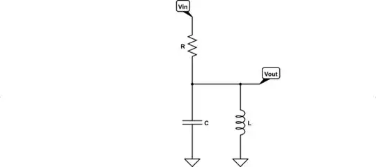

I am trying to determine the general transfer function of the following circuit. enter image description here
Shouldn’t the transfer function just be \$R + \frac{Z_CZ_L}{(Z_C+Z_L)}\$? I am trying to then use the transfer function to solve for the damping coefficient by plugging in values for R and C, but I can’t seem to figure this out.

No, that's the input impedance. A transfer function relates Vout to Vin using the Laplace operator, \$s\$. Drilling down through your circuit starting from here: -
$$\dfrac{V_O}{V_I}\hspace{0.5cm}=\dfrac{Z_P}{R+Z_P}$$
Where \$Z_P\$ is the impedance of the inductor and capacitor in parallel. This becomes....
$$\dfrac{V_O}{V_I}\hspace{0.5cm}=\hspace{0.5cm}\dfrac{sL}{s^2 LCR + sL +R}\hspace{0.5cm}=\hspace{0.5cm}\dfrac{s\frac{1}{CR}}{s^2 + s\frac{1}{CR} +\frac{1}{LC}}$$
Directly above is the latex formula (in case you are interested in prettying your algebra).
I am trying to then use the transfer function to solve for the damping coefficient by plugging in values for R and C, but I cant seem to figure this out.
The denominator above is of the form where: \$\hspace{0.5cm}2\zeta\omega_N = \frac{1}{CR}\hspace{0.5cm}\$ and \$\hspace{0.5cm}\omega_N^2 = \frac{1}{LC}\$
  • Zeta (\$\zeta\$) is the damping ratio.
  • \$\omega_N\$ is the natural (undamped) resonant frequency (sometimes called \$\omega_0\$)
Hence, \$\hspace{0.5cm}\zeta\hspace{0.5cm} =\hspace{0.5cm} \frac{1}{2R}\sqrt{\frac{L}{C}}\hspace{0.5cm}\leftarrow \hspace{0.2cm}\$ (corrected as per comments)

  • Hi, Thanks so much for your response! I think I am still a bit confused as to where the components of the transfer function are coming from. I understand that Vout=VL since we are measuring the voltage across the inductor. Do you mind going into a bit more detail as to where the denominator of your transfer function is derived from the circuit? Thanks! – BiggestGrits Mar 19 '23 at 20:55
  • @BiggestGrits I've added a line to help – Andy aka Mar 19 '23 at 21:06
  • @Andyaka I think your fraction within the sqrt for zeta is upside down. Could you check that and see if I'm right? – periblepsis Mar 19 '23 at 22:08
  • @periblepsis oops you are quite correct. Fixing.... – Andy aka Mar 19 '23 at 22:20
  • @Andyaka Thanks. I'll +1 now. I added something I was writing when I noticed your error. Decided to finish it off, anyway. – periblepsis Mar 19 '23 at 22:28
  • Hi, sorry to keep asking, but Im confused where the RCL(s^2) term in the denominator is coming from. Simplifying the transfer function would yield Zl/(ZlZcR+R+Zl)- correct? so in this case wouldn't substituting in values for L and C cancel out the s term in the denominator? Thanks again! – BiggestGrits Mar 19 '23 at 22:59
Get rid of the input supply and don't bus wires:
Without over-thinking things too much yet, the above may be a little easier to notice as a simple voltage divider: \$V_{_\text{OUT}}\$ is just a divided-down part of \$V_{_\text{IN}}\$. So \$V_{_\text{OUT}}=V_{_\text{IN}}\cdot\frac{Z_{_\text{C}}\mid\mid Z_{_\text{L}}}{R+\left(Z_{_\text{C}}\mid\mid Z_{_\text{L}}\right)}\$.
Or put another way, \$\frac{V_{_\text{OUT}}}{V_{_\text{IN}}}=\frac{Z_{_\text{C}}\mid\mid Z_{_\text{L}}}{R+\left(Z_{_\text{C}}\mid\mid Z_{_\text{L}}\right)}\$. That right side is the so-called transfer function.
Plugging in \$Z_{_\text{C}}=\frac1{s\,C}\$ and \$Z_{_\text{L}}=s\cdot L\$ you might get this: \$\frac{V_{_\text{OUT}}}{V_{_\text{IN}}}=\frac{L\,s}{R\,C\,L\,s^2+L\,s+R}\$. You don't need the numerator to work out the damping factor. All you need are the coefficients in the denominator, \$a_2\,s^2+a_1\,s+a_0\$, as \$\zeta=\frac12\frac{a_1}{\sqrt{a_2\cdot a_0}}=\frac12\frac{L}{\sqrt{\left(L\,C\,R\right)\cdot R}}=\frac1{2\,R}\sqrt{\frac{L}{C}}\$.
(If you need or want an explanation about how to derive \$\zeta\$, ask.)

  • Hi, after finding the transfer function, wouldnt the s^2 term in the denominator actually cancel since you would be multiplying 1/sC by sL? – BiggestGrits Mar 19 '23 at 23:01
  • @BiggestGrits I don't understand what you are seeing. But clearly there are two answers here which arrive at the same result for zeta. Perhaps consider editing your question and inserting more details? Or write a longer comment so I can follow your logic? I generally get the idea that you think multiplying 1/sC by sL should cause the two 's's to cancel. But I don't understand any of why you are doing that. Do you need to be step-wise walked through the algebra? – periblepsis Mar 19 '23 at 23:17
  • No problem! I think I'm really just confused about simplifying the transfer function. I understand now that the transfer function is just Vo/Vi = Zp/(R+Zp), where Zp is the total impedance of the two components in parallel. Maybe I am not calculating Zp correctly, I have Zp = Zl/(ZcZl+1). So substitution for Zp gives me Vo/Vin = Zl/(ZlZcR+R+L). Substituting for Zl = sL and Zc = 1/sC in this case does not give me the same transfer function as everyone else. hopefully this is enough detail! – BiggestGrits Mar 19 '23 at 23:30
