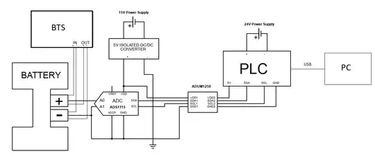

I want to read a DC voltage from a battery with 0.1mV resolution or better and send the value to a PLC based in Arduino Mega. I selected an ADS1115 (datasheet here) which has enough resolution to do that. I already created a question in the past (this one), which was very helpful as I improve the reading a lot by doing 2 things: connecting the ground to the negative pole of both the battery/ADC input (to assure common ground for differential mode), and isolating the digital part (to avoid digital currents getting to the ADC input by ground loops). However, I still have some ocassionaly oscilations in the reading as I will explain in detail. The final set-up after the answers from the previous question looks like this:
ADS1115 is from Adafruit which break out board is mounted on a breadboard. ADUM1250 is used in its evaluation board and connected to the breadboard. Last but not least, the BTS is a battery test system connected to the battery which has two functions:
  1. Battery cycling. It injects a constant current (100 mA) in the following way: it starts injecting +100 mA to charge the battery, and after some minutes it injects -100mA to discharge the battery (and the process repeats several times). This is done by OUT connection, using both positive and negative cables to the battery poles respectively.
  2. DC voltage measurement. The BTS also provides an stable and correct measurement with no oscillations (using IN connection, also using positive and negative), which is used as a reference to compare with my ADC measurement. I also did the measurements with a multimeter which matches perfectly the BTS value. So it is clear that the problem is in the ADC reading.
My feeling is that there is some voltage drift entering the ADC. To give more tips about the oscillation that maybe can help to identify the issue, the following table shows an example of the it compared with the BTS/multimeter reading. ADC datarate is set to the maximum value (860 samples per second) and then the PLC stores the last value in a variable and prints it every 2 seconds to a file:
These values are during a discharge cycle (voltage always decreases along time). As the time goes on (epochs every 2 seconds), BTS always reads an smaller value (-0.0004V or -0.0003V compared with the previous one). However, the ADC occasionally reads +0.0001V (epoch marked in red color), which is a larger value than the previous one, and this mess up completely my further computations. I need a clear signal, it is not a solution for me to filter by software.
What could be the cause for this ocassional oscillations? They always happen in the opposite direction of the cycling: if the battery is being discharge, voltage goes up, but in the battery is being charge, the voltage goes down. Besides, there is an offset around 60mV on the ADC readings compared with the reference readings which I cannot explain. This offset does not affect my computations but maybe gives some clue of the problem.
I tried to replace the ADS1115 by an ADS1219 but the results were the same so it seemts that something in the ADC inputs or outputs is still affecting.

    Are these single ADC measurements made once per two second? You use the words epochs and, I think you mean samples? Have you done an error budget calculation for the ADC? Please link the data sheet of the ADCs. What ADC voltage reference are you using? – Andy aka Mar 18 '23 at 12:01
    What about the other inputs on the ADC1115? How much settling time do you provide for the multiplexer? – Andy aka Mar 18 '23 at 12:07
    Was this project using the code where the averaging was done using copying floating point numbers around in two separate timer interrupts like it is safe but isn't? – Justme Mar 18 '23 at 12:15
  • @Andyaka I have just updated the question. ADC samples at 860 sps, and then at the PLC I store the last value in a variable and print it to a file every 2 seconds (because the BTS also gives values every 2 seconds). The ADC voltage reference is the internal one, I have added the datasheet link. I don't understand what you mean by other ADC1115 inputs? and what do you mean by settling time in the multiplexer? – bardulia Mar 18 '23 at 12:15
  • @Justme yes it is! However, that averaging does not remove the oscillations. – bardulia Mar 18 '23 at 12:16
    Have you tried replacing the battery with an accurate fixed value voltage source and see if you still have the problem? In other words; divide and conquer or, deal with the errors from each sub-system rather than trying to debug the whole system. – Andy aka Mar 18 '23 at 12:24
    @Andyaka No, I haven't, but it is a interesting idea. I will try it. – bardulia Mar 18 '23 at 12:26
    Breaking the system down into parts is a tried and tested way of solving problems like this. – Andy aka Mar 18 '23 at 12:28
    Perhaps a mix of GND and AGND on the ADS1115 board? – Antonio51 Mar 18 '23 at 12:53
    I think the code is just not interrupt safe and copying around floats in a couple of timer interrups is just very awkward way of trying to achieve what you want. Fix the code so that you know the code is not causing the issues you are seeing. It may be a code problem and not a problem in hardware. – Justme Mar 18 '23 at 12:55

    The ads1115 has two grounds (gnd and agnd). Only the gnd ground is used ... so that agnd is "floating" ... and measurements also... by a little voltage. So, your offset between your BTS values and ADC values. Note also that your reference is not "fixed". – Antonio51 Mar 18 '23 at 15:49
    Only the agnd should be wired to your system. Gnd is wired with the power supply of the sub_board. – Antonio51 Mar 18 '23 at 15:57
    @bardulia It depends what your main code does. But you seem to be doing all the things you should never do in interrups, such as printing. Unless you know how the MCU handles interrupts, and how the mystery Arduino code modules function, and what you can do or not in interrupts, you should not do anything more that you have to in interrupts. And I have never written any Arduino code in my life and I would not use any Arduino code on AVR so I have no clue what you should do. – Justme Mar 18 '23 at 15:57
  • @Antonio51 I am checking ADS1115 datasheet and it only talks about one ground (GND) on pin 3, no info about any AGND. I am also checking Adafruit ADS1115 breakout board and it also has only one ground (GND) that recommends to wire to the AGND of the circuit. What do you mean by "Gnd is wired with the power supply of the sub_board"? – bardulia Mar 18 '23 at 17:50

Here is your ADS1115 breakout board power supply:
Here are the GND and AGND pins of the breakout board.
(GND and VCC) should be wired to the power supply and (AGND & AVDD) wired to the main system.
