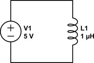

Suppose we have an L circuit with DC power supply of emf \$\mathscr{E}\$
By KVL,
\$\mathscr{E}=L\frac{dI}{dt}\$.
This suggests that \$\frac{dI}{dt}=\frac{\mathscr{E}}{L}\$
As at \$t=0\$, \$I=0\$
So, current increases at a constant rate from \$0\$.

But how this is achieved in the original circuit?
In the original circuit, an external voltage is applied across the inductor. By Faraday's Law, the rate of change of flux is constrained to a fixed value different from zero.$$\frac{d\phi}{dt}=-\frac{1}{N}V$$
This is like accelerating a mass. The actual velocity can be zero but the acceleration can be very large at the same time.
The applied voltage also places an electric field along the wire accelerating the electrons.
But Farady's Law does not include inductance or current. So let's take a closer look by introducing current into the law by writing:$$v=-N\frac{d\phi}{di}\frac{di}{dt}$$
Inductance can easily be recognized$$L=-N\frac{d\phi}{di}$$as the ability for current to establish a magnetic flux in a region of space. It depends on the medium and the number of turns.
it is not evident what is the cause of constant rate of change of current which leads to a constant emf across the inductor.
So the applied voltage does double duty.
  1. The current is produced by the electric field created by the voltage.
  2. The rate of change of current is constrained by the voltage and the inductance to a fixed value.
The constant emf is because the applied voltage is making it so. The constant applied voltage leads to a constant rate of change of current. Not the other way around.

  • thanks for the reply. If we have a situation that we have an inductor between the Helmholtz coils, then it is evident that as we increase the current at constant rate through Helmholtz coil, magnetic field between it increases and thus the magnetic flux through the inductor and this induce a constant emf. But in the case of the circuit shown in the question, it is not evident what is the cause of constant rate of change of current which leads to a constant emf across the inductor. – Iti Mar 18 '23 at 08:22
