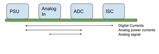

    @bardulia I added a quick MSPaint drawing showing the orientation of parts and the direction of ground current. If you want you could twist differential pairs and use 1 common ground next to them, although two grounds would also be fine, 1 per half of the pair. – user1850479 Mar 17 '23 at 15:48

What I personally practice, is to manage the ground currents, where they must flow, and what they might couple into along the way. Think of the blocks below as a simplified PCB veiwed from the side Simplified PCB veiwed from side
In this 2D PCB, the analog signal is routed along the same path as both the digital currents and the ADC's power currents, providing plenty of oppourtunity for cross over. Even if the digital circuit is nowhere near, the power supply currents still have to make thier way back to the PCB, so if these current's pass the ADC input there's potential for noise. If I swap the blocks aroundsimplified PCB diagram
Now the analog circuitry is not exposed to any other currents in the ground path. This is obiously a pretty oversimplified example, but the principle applies to a 3D PCB. Remember that the return path will always be the lowest impedance path back to the point of generation, and then design your circuit so your return paths are seprated.
