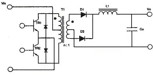

Here is a schematic draft : enter image description here

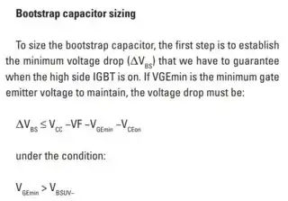

This Infineon IRS20752L application note, DT04-04 'Using Monolithic High Voltage Gate Drivers', gives in detail the procedure and equations for calculating the bootstrap capacitor value (introductory sample show below).
It refers to the supply decoupling capacitance but does not specify how to calculate it. You could use very a rough estimate value for the decoupling capacitor, such as 100 nF in parallel with 10 uF, located close to the component pins with the 100 nF closest. A calculation is better but these values are likely to be plenty. They're much higher than the Ciss (gate-source capacitance) of even a large MOSFET.
(START OF APP NOTE, READ IT FURTHER FOR DETAILED SOLUTION)
