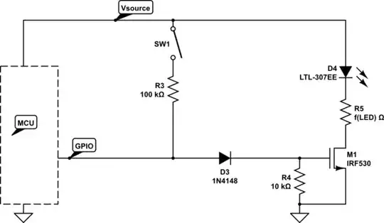

Below schematic shows a USB connection diagram.IN this you can see a common mode choke (DLW21HN900SQ2L)
The common mode choke impedance is given as 90 Ohms @ 100 MHz .The USB is working at 480Mbps.
I know that the characteristic impedance of USB is 90ohm.
My Question is we need to select a common mode choke with 90ohm impedance at 480Mbps. Please correct me if I am wrong.
