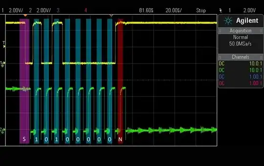

I measured the signals to see what is happening and it seems that the timings are OK in both cases (working and not working).
Correct I2C communication (3 bytes reading): enter image description here
I2C FRAM address not acknowledged (slave address is correctly sent): enter image description here

I ran tests with the SCL frequency set to 50kHz and 10kHz. I measured the SCL signal with an oscilloscope to ensure that it was at the expected frequency.
These modifications didn't solve the problem. I checked the timings and they are within the FRAM datasheet specifications.

I tried to put a stop before the repeated start during bytes transfer. I measured the byte transfer with the oscilloscope: the STOP condition followed by the START condition is OK.
Unfortunately, this solution doesn't solve the problem.

10k seems a bit big for your pullups, and your leading edges look slow. Reduce the resistors to about 3k and see if that helps.
Also, why is the off voltage drifting with time?
Scott Seidman
  • 29,274
  • 44
  • 109
  • I reduced the pull-up resistors to 3.3k and that doesn't help. I have no idea regarding this drifting. – johsey Apr 16 '13 at 12:02
  • It looks small on the screen, but its about 250 mV, I think. You might be having a power supply issue on the 3.3V side – Scott Seidman Apr 16 '13 at 12:14
  • You're right, the drift is about 300mV on both sides of the I2C level shifter. The +3.3V power supply seems to work fine (no drift in its output when the drift on the SCL signal is occurring). Could it be related to the I2C level shifter? – johsey Apr 16 '13 at 12:59
  • Not sure at all. Where's 3.3V coming from? Switching converter? In any case, it's suspicious. Are you drawing MINIMUM current required by the device providing 3.3V per the datasheet? If not, load your supply with a resistor. What happens if you wait a second or two before starting communication? – Scott Seidman Apr 16 '13 at 13:02
  • 3.3V is coming from a SMPS (LM3103MH from TI). I'm not an expert in power supplies but as I understood, with this device, there's no minimum required current since it can operates in discontinuous conduction mode at a light load. The same problem occurs if I wait two seconds before starting the communication. – johsey Apr 17 '13 at 06:56
