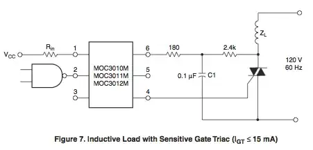

I've seen in several places this snubber circuit composed of 2.4K and C1 in this particular case.
My question is - what's the purpose of this network exactly and how are the values for the resistor and capacitor calculated?
Does it provide a phase shift so that power triac could be turned on on zero crossing and if so, how does it work?
It's said, that it is designed for power triacs with sensitive gate Igt < 50mA. What do I do if my power triac's gate is not sensitive (> 50mA)?

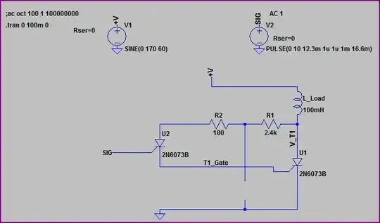

To show how this can cause issues, here is a rough approximation of the circuit without the capacitor:
Triac no snubber
Here is the simulation, notice when the current approaches zero and the main triac tries to turn off, there is a transient - this spike passes through the control triac, causing a spurious trigger and keeping the main triac turned on.
Triac no snubber sim

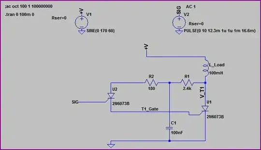

So we add the capacitor back in:
Triac snubber
Now we simulate, and see the circuit functions as expected. The snubber shunts the transient pulse to ground and prevents the main triac from staying on.
Triac snubber sim

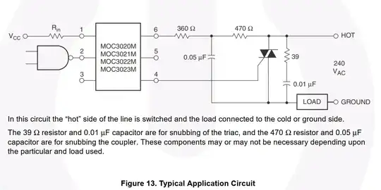

Here is a good circuit to start with but just remember, if you are doing PWM on the optotiac then use a non-zero opto. Zero cross is for continuous duty, not PWM. Please remember if the load is on the high side that means it is energized all the time-not good, use the low side always.
Optotriac typical application circuit from Fairchild (now On Semi)
(Image source: Mouser - Fairchild MOC3020M datasheet)
Please look up Onsemi data sheet, also Vishay, Little fuse, Fairchild, Toshiba, and STMicro specifically application note AN5114.
If all you want a better picture of how to design a better Triac circuit, you have to read the application notes. Each manufacturer is different, but a general circuit can be built for all.
If a non sensitive trigger Triac is used then for your circuit you posted, use a 1.2 kΩ in place of the 2.4 kΩ and use a 200 nF C1. Another good note is ALWAYS use a snubber regardless if they say not to. This goes for the Triac as well as the Opto triac. Also do not forget the inductor, which may not be needed according to your circuit demands. If it is a motor control then use one.
