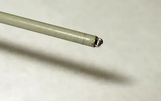

    The Tektronix clips are hard to open, because the plastic head tips to the side and jams instead of sliding down when you try to squeeze it. The HPs don't have that problem. The Tek pincers are made of wire, so they splay out sideways instead of grabbing well (and get permanently bent, making them jam on each other and not close completely, so connections to thin wires are intermittent).
    Wire tips jammed together

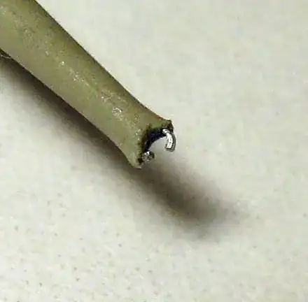

The HP pincers are made of thin strips of metal, so they are more rigid in that direction. The wire pincers depend on the bendiness of the wire to overlap each other side-by-side (which doesn't work very well) while the HP pincers fold inside each other, with one a little shorter than the other. This seems to work better, but they get bent outward, and the tubes are plastic, so they get bent outwards by any angular stress and no longer close well.
Tip splayed open
