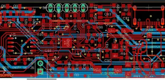

Schematic and PCB design:

I see several problems in this designs layout, and one or a combination of them could very well be the reasons for your problems.
The first problem I see is with impedance matching of the usb line, I assume from your picture of the layout that this is a 2-layer board. If that's the case the USB data lines are not impedance matched, which might cause problems when communicating with the board due to reflections from the impedance mismatch, the vias on the data lines also does not help. However, this is not a huge problems on this slow USB standard but still something that should be corrected.
I also see other minor layout errors but the biggest problem with the layout is that you don't have any clear return path in the PCB for all your signals (check this video when you have time https://www.youtube.com/watch?v=ySuUZEjARPY, it will change your whole perspective of PCB layout). The short summary is that your design in its current state will have A LOT of crosstalk as the traces return in each other which could be ruining the USB signal enough to not work correctly.
I would also like to comment on the USB-C connector, in its current states it's technically violating the USB standard since you don't have any pull-down resistors on the CC pins. The only reason it still works is probably due to luck that the hosts usb port you are using allows it to pull the standard power or some other limited amount or that you are using a USB-C to USB-A cable or such because then the CCs are probably left unconnected.
To sum up, I would suggest redoing the layout of this design as I suspect that it might be the problem from the given information. I would also as @Justme sugest to further check on the boards what's working or not, to eliminate other possible issues.
    I bet the memory chip ground pin is connected, the picture just does not contain a ground plane. – Justme Mar 08 '23 at 13:13
  • Yeah you are right, I didn't see but there is actually a dotted rectangle around the ic – SuperLeggera Mar 08 '23 at 13:59
  • We have tuned the USB differential pairs at 100%. What do you mean by "you don't have any clear return path in the PCB for all your signals" can you please elaborate? We ae not trying use USB-C as an OTG. CC pin is probably not the issue here. – Samiksha Mar 09 '23 at 09:57
    Are you sure about the USB differential pair? From the layout it looks like you have used 0.3mm width for the differential pair then the spacing between them would have to be only 0.07mm to achieve a differential impedance of 90 ohms, (assuming its routed as a coupled differential pair which seems to be the case). 0.07mm spacing is beyond the capabilities of most low cost fabs, therefore, my doubt about the traces being impedance matched. Also since you don't have a solid ground plane under the diff pair their characteristic impedance will change throughout the trace. – SuperLeggera Mar 09 '23 at 14:55
  • Take a look at this article for more info: https://resources.altium.com/p/routing-requirements-usb-20-2-layer-pcb – SuperLeggera Mar 09 '23 at 14:59
    Return path refers to where you signals current returns, I can try to explain it but I would suggest reading this article instead as I feel it gives a better explanation than I can: https://www.nwengineeringllc.com/article/how-to-design-your-pcb-return-current-path.php – SuperLeggera Mar 09 '23 at 15:01
    And I agree with you that the CC pin is probably no the issue here as you get power to the board, but I would still fix it at least for the next iteration of the board. – SuperLeggera Mar 09 '23 at 15:02
  • *Correction on my first comment regarding the USB matching, I mean to write coupled microstrip line and not coupled differential pair – SuperLeggera Mar 09 '23 at 15:05
    Yes, I am sure. If that was the case then how come I am able to detect 2040 as a mass storage device with absolutely no error. USB routes are not the issue here too. :( – Samiksha Mar 10 '23 at 04:39
