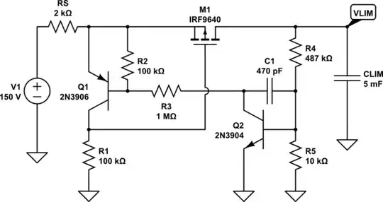

All components in the circuit below have 2 or 3 terminals. Hopefully that's discrete enough for your taste :)
The 1st part of the circuit is the voltage limiter. The circuit you proposed has a fatal flaw: it will not work properly when the input voltage is exactly 24V - and that's the steady state of the overall circuit. When 150V via 2k is loaded with a 1.6W load, the voltage drops to 24V. Instead of an N-type pass element, we need a P-type pass element:
This is the 2nd part of the circuit: the load switch with hysteresis. The load is turned on when the C1 voltage raises above 25V. The load is turned off when that voltage goes below 23V.
CLIM must be about 25x larger than the load capacitance CL.

  • I am not sure to understand when you said "When 150V via 2k is loaded with a 1.6W load, the voltage drops to 24V". The PNP Q1 and D1 acts as an LDO regulated at 30V. When the 1.6W is switched on it will pulls 53mA. C1 supply the inrush current. Since maximum current is 75mA it works and I have tested it and I confirm that C1 has to be increased (works with 4.7mF) – hiak Mar 03 '23 at 08:13
  • Please turn D100 and change symbol to Zener. – winny Mar 03 '23 at 09:27
    @winny It’s an ideal simulation element. Turning it to a Zener would change behavior not to match what the previous stage is doing. – Kuba hasn't forgotten Monica Mar 03 '23 at 12:32
    @hiak Try at lowest line voltage :) The 2k resistor is really marginal. It all just barely works. It makes the capacitor charge times long. It should have been 1k, and then the only reason for having it is to shed heat away from the pass element. – Kuba hasn't forgotten Monica Mar 03 '23 at 12:34
  • A breakover diode? – winny Mar 03 '23 at 13:54
  • @winny D100 is just a model not a diode. It represents the first circuit in the answer. It sinks some current to limit the voltage at the M10 source. Putting a zener will sink all the available source current an the load will have nothing. Zener is much lower impedance path comparing to the load. – hiak Mar 03 '23 at 16:37
  • @Kubahasn'tforgottenMonica I do not worry about lowest line voltage. The 150V is well regulated and if it drops there is no need to power up the board. – hiak Mar 03 '23 at 16:40
  • What model are you using for it? – winny Mar 03 '23 at 16:59
  • @winny An ideal diode model. – Kuba hasn't forgotten Monica Mar 21 '23 at 19:35
