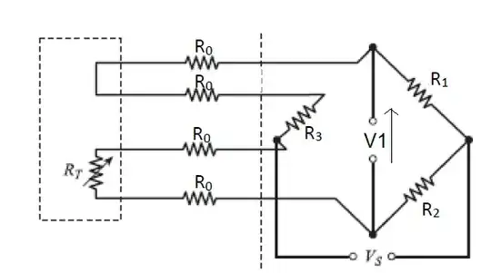

Here is a scheme of the circuit: enter image description here
I know the basic equations to calculate voltages at R1, R2, R3, and PT1000, but I am not sure how to calculate the voltage at the output of the LM358P, depending on the values for R1,... , R4 or whether and how to include the operational amplifier in these calculations.
