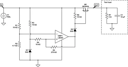

I got hooked, here's an implementation using a comparator, the LM393:
simulate this circuit
R1 and R2 provide a fraction of the input voltage to the comparator, which compares that to a more-or-less fixed 5.6V reference, provided by R3 and D1.
R4 gives some flexibility to that potential, so that it may be modulated somewhat by the comparator's output, via feedback resistor R5. This provides positive feedback for hysteresis, which I'll show you in the graph below.
D2 "adds" 5V or so to the comparator's output, before it's applied to the gate, which serves two purposes. Firstly it ensures that \$V_{GS}\$ never gets close to the maximum of 20V for the MOSFET. Secondly, the behaviour of the comparator is not guaranteed for \$V_{IN}<2V\$, and D2 ensures that the transistor cannot be switched on accidentally, before \$V_{IN}\$ reaches a level where we can be sure that the comparator will behave itself.
Here's a plot of \$V_{IN}\$, an input that sweeps up and down through 17V, and the resulting \$V_{OUT}\$:
The main features here are the very clean transistions of \$V_{OUT}\$, due to positive feedback, and the two different transistion thresholds, or hysteresis.
This hysteresis is probably necessary, because as the input rises through 17V, the sudden additional load can cause it to drop again, a recipe for oscillation. Change the ratio of R1 and R2 to set the midpoint of the switching thresholds, and raise/lower R5 to decrease/increase hysteresis "gap" respectively.

    @Xhero39 I also added a comparator-based design. That graph is from a CircuitLab simulation, so you can also mess around with resistor and diode values there, to get a feel for what's going on. Or, you can rebuild the circuit in LTSpice, to check that CircuitLab isn't pulling your leg! Have fun! – Simon Fitch Feb 24 '23 at 05:59

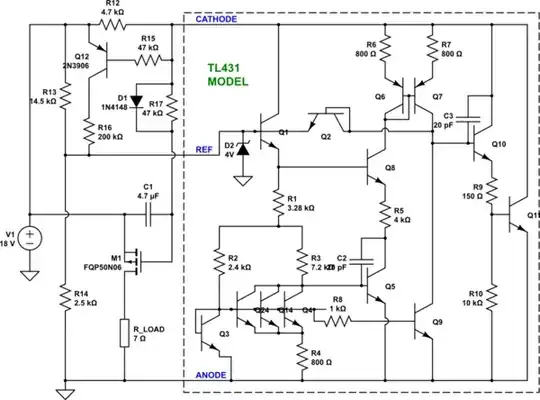

The circuit below should do what you intend.
TL431 becomes a "short" when the REF input goes above about 2.5 V. The R13, R14 divider provides the reference voltage to TL431. When input voltage goes above 17 V, the reference voltage rises above 2.5 V, and TL431 starts conducting hard. This conduction current causes a large voltage drop across R12, and discharges M1's gate in parallel with C1 via R12+R17. M1 turns on gradually, as its absolute gate voltage drops, keeping inrush current manageable.
At the same time, Q12 turns on as well, and shifts the threshold voltage down to 16 V. This is the hysteresis necessary to avoid potential instability during the turn-on and turn-off transient. Increasing R16 decreases the hysteresis voltage*. If the hysteresis is undesired (and it almost never is!), remove Q12, R15 and R16.
When the input voltage drops below 16 V (with hysteresis, or 17 V without), TL431's conduction current drops to idle (<0.5 mA), and C1 in parallel with M1's gate recharges via R12 and D1. This causes the load to be turned off about 10x as quickly as it was turned on.
Since CircuitLab doesn't have a built-in TL431 macro/model, I've added a low-level model of TL431 inside the dashed box. This model is only needed for simulation: in the physical circuit you'd use an actual TL431 part.
The voltage across the load and the absolute V_GS on the mosfet are plotted below vs. the input (USB) voltage.
The load and gate voltage vs. the input supply voltage
The transient response on turn-on is plotted below:
The load voltage and gate voltage vs. time on turn-on
