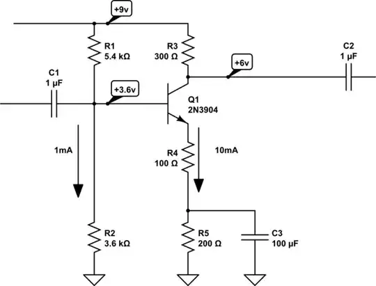

Perhaps something like this:
The IXDD609PI is a gate driver to switch the two MOSFETs smartly. The IPP120P04P4L03AKSA2 is a hefty P-channel MOSFET. R1 represents whatever is limiting the capacitor charge current. If you don't add external resistance it will be limited by the power supply (internal resistance and current limit), capacitor ESR, wiring resistance, M1 MOSFET on resistance and wiring resistance.
Common ground between the ATX supply and MCU is assumed. Heavy currents flow in some of the wires so some layout care is called for. Even the gate currents can be several amperes (briefly), hence ceramic MLCC capacitor C2 placed close to the gate driver chip power pins. A few ohms in series with each gate might be a good idea (5 to 10 ohms) to slightly slow the switching.
Keep in mind that if M1 and/or M2 fails, it/they will likely fail shorted, so your device should deal with that in a safe manner.
The driver is non-inverting, so a 0V input signal results in the capacitor charging through M1 and (if present) R1, and a 3.3V input results in the capacitor discharging through R2 and M2.
