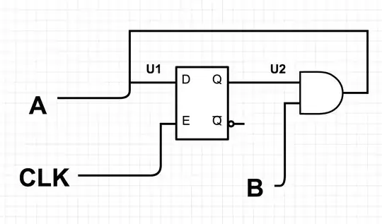

Although other answers have covered almost everything there is to say about your question, to make it more clear I have added a few diagrams and a short explanation.
Imagine you want to design a circuit that includes some sort of a feedback. Say A = A.B(basically an AND gate with a feedback). If you implement it using a simple level sensitive latch that stores the value of A, your circuit will look something like this enter image description here
This can create a problem. When the clock is high, the latch becomes transparent, and the AND gate computes the new value of A and B. But the value is fed back to the latch, and since the latch is still transparent (CLK is still high), the new value of A AND B is computed. This is what is commonly referred to as a Race Condition, which creates glitches (unexpected highs and lows in the output) that you mentioned.
One solution to this problem would be to keep the CLK pulse very short, short enough that once the output of the AND gate is generated, the latch is deactivated before the value is backpropogated to the input again. It should be intuitive to see why this may be difficult to achieve. It would depend on the switching speed of the latch (finally, a latch is also made out of combinational gates), the length of the wire, and hundreds of other parameters.
A second more feasible option is to use an edge sensitive element (a flip flop in this case), which is basically a couple of latches connected in a very clever way.
Basically, when the CLK signal is high, latch U1 is transparent, which brings the logic value at the A input to the output of latch U1, when the CLK signal is LOW, the latch U2 becomes transparent, and a new value of A AND B is calculated. But this value will propagate to the input of the AND gate only when the latch U1 becomes transparent (CLK is HIGH), and consequently latch U1 becomes transparent (CLK is LOW). Which is basically equivalent to saying that the circuit is now edge sensitive (the output value changes only at the negative edge of the clock).
This avoids the problem of Race Condition explained earlier, and that is why level triggering is preferred over edge triggering.

  • Thanks! So, with the first example, the problem is they'll be a loop: after the first AND is computed, it'll go to A and be stored in the latch, and the latch will then feed a new input to the AND gate, which will go to A and be stored in the latch, and the latch will then... for however long the clock cycle is? – mmm111mmm Mar 30 '20 at 20:14
