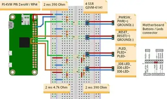

The "relay" is an optically isolated MOSFET switch. The isolation, or relay action is useful because it lets you control circuits with different power supplies without worrying about bad things happening.
It has an IR LED internally, and that drives a set of MOSFETS. The 390Ω resistors are placed in series with the LED to limit the current. For a 5V system (ATX side), 390Ω limits the current to about 10mA. You can see the internal connections in the datasheet figure below:
The current required to reliably "trip" the relay is just under 3mA. As long as you adjust the LED resistor to allow more than that, it will reliably switch. Increasing the current makes it switch faster, but that probably isn't important. Any current value greater than 3mA and less than 25mA is good, though you may need to keep it on the lower end for the drive circuits.
Under the section "Setting up the V2" I found the following diagram. The 4.7kΩ resistors are used to provide a pull-down to provide a digital logic value for the PI side of the system when the LED is "off". enter image description here

  • Thanks so much! Now that makes sense with the resistors and so I know that I can also use my 330 Ω resistors since that would be a safe value (= 15 mA). You wrote for 390 Ω it would be about 10 mA at 5 V, but isn't it to almost 13 mA? – Tintenfisch Feb 14 '23 at 23:33
  • So my assumptions were correct. And it is a very odd circuit then. It makes little sense to add extra resistors for the optorelay, if the motherboard already is intended to drive LEDs directly and thus already has built-in resistors, so there may be lower current than recommended for the optorelay input. It will work without resistors if the polarity is correct. Which is also an odd choise to require polarity, because the relay output side can be connected in any polarity to the button pins. Some motherboards do not state which pin is ground and which is signal, so it will work in any polarity – Justme Feb 14 '23 at 23:34
  • Good point. Maybe PLED and IDE-LED are even driven by limiting the current instead of using a resistor, but I am not sure. Do you think that also applies to PWRSW and RESET? – Tintenfisch Feb 14 '23 at 23:51
  • @Tintenfisch Current limiting is just simplest with a resistor. But any motherboard manufacturer can implement whatever they want on the front panel interface. They should be just raw buttons and raw LEDs so any circuitry possible could be implemented to interface them, and therefore, no assumptions should be made how they are implemented. For example, the LED could be switched from the anode or cathode side, and the resistor could be on anode or cathode side. And the supply voltage could be modern 3.3V or legacy 5V. And same for buttons. There is no standard that says how it should be. – Justme Feb 15 '23 at 08:39
  • @Tintenfisch The LED has a forward voltage of about 1.1V, which is how I calculated 10mA. See this question for a better explanation: https://electronics.stackexchange.com/questions/17179/correct-formula-for-led-current-limiting-resistor – W5VO Feb 15 '23 at 18:14
  • I'm not certain whether the standard case LED has its current-limiting resistor on the motherboard or in the case (on a small circuit board). It's definitely safer to include them as a "common" value of resistor would probably only halve the current to the relay IC. The circuit seems very reasonable to me, I wouldn't recommend deviating from it. Minor changes in resistor values will probably not cause any issues (e.g. next value up or down). – W5VO Feb 15 '23 at 18:22
  • I'll use the original schematic. Only thing I still did not find is which GPIOs I need to connect for a RPI 4 and RPI 3. Thank you all of you guys! – Tintenfisch Feb 15 '23 at 20:23
  • @Tintenfisch The Raspberry Pi models share a common 40-pin header I believe - the wiring diagram is probably good for all versions. – W5VO Feb 16 '23 at 15:19
  • @W5VO: Hi! I finished it now :) All of it works (PWR, RESET, PLED and IDE/HDD-LED) - both on the case and the PIKVM. I assumed that just splitting them was enough, correct? For instance, the case's PWR cable is plugged into the ATX PCB I soldered and from there another cable is plugged into the FRONTPANEL header on the mainboard. See a photo of the work here: https://i.prvy.eu/n62srlh.jpg – Tintenfisch Feb 24 '23 at 22:42
