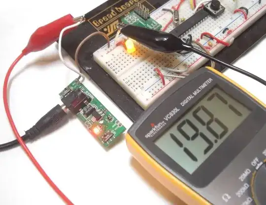

Use alligator clips for your DMM test leads and pin it on the leads of your breadboard wires ( terminals) where you want to test.
Please see the below picture to understand what I am trying to say.
Breadboard + DMM
Please for heaven's sake don't try forcing those test lead pins into the breadboard holes, they damage the copper strip inside (personal experience.)

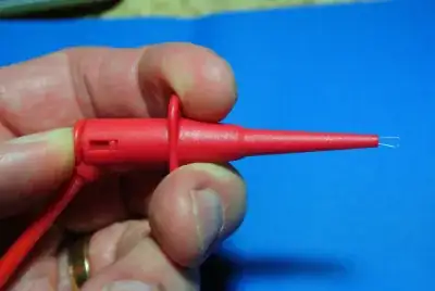

You could either make some leads up, with banana jack on one end (available from any decent electronics vendor) and header pin, crocodile clip, or similar on the other.
Or do what I have done many times and just grab a bit of solid core wire (of a size suitable from breadboard), strip at both ends, wrap one end a few times around the test probe with needle nose pliers and stick the other end in the breadboard.
Oli Glaser
  • 54,990
  • 76
  • 147

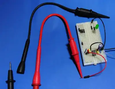

You can also buy accessories that plug onto the end of your test lead probes which provide a little grabber for attaching to small component leads and jumper wires etc.
Of course, a short bit of bare wire twisted round the probe is a lot lot cheaper :-)

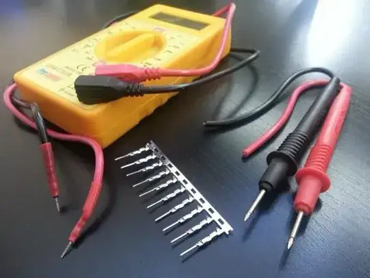

If you are not planning on doing any high voltage measurements then I would suggest cutting off the standard tips and soldering some male crimp pins. You can insulate them with heat shrink to enhance their longevity.
It's been working great for me. Here is a picture of my setup and some crimp pins: crimp pin meter
If you find it hard to buy male crimp pins then you can emulate this with a jumper cable or a pin from a breakaway header soldered permanently into a BLS housing.
Tomasz Wasiluk
  • 173
  • This is a great solution. I would just make a second set of wires that are of a convenient length and thickness with the thin pins and new 4mm banana plugs, that way you save the factory probes for other testing. – KalleMP Jun 26 '19 at 11:03

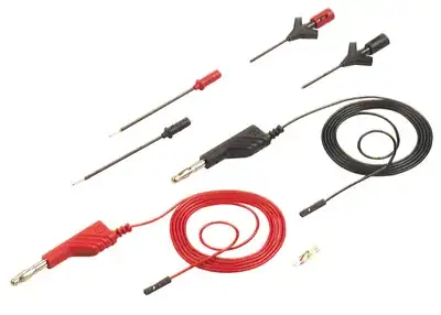

Neither cheap nor simple, but I like the micro clips from the Hirschmann PMS 0,64 set best (clipped to a wire):
(source: sks-kontakt.de)
