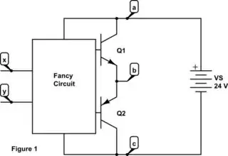

FIgure 1 below shows a crude model of an operational amplifier. The lowercase letters are the names of the accessible nodes. Notice that no reference node is specified or indicated. This makes it impossible to talk about the voltage \$V_a\$ for example or any of the other nodes using single subscript notation. However, without knowing the voltage at a reference node, the quantity \$V_{ac}=V_a -V_c\$ can easily be determined as 24V, as long as the same reference is used even if the voltage there is unknown. The fact that \$V_{ab}\$ is positive can also be determined.
So how does this crude operational amplifier work. First the voltage \$V_D =V_{xy}= V_x-V_y\$ is defined. This allows us to have a known voltage from \$x\$ to \$y\$ even if the actual voltages \$V_x\$ and \$V_y\$ are unknown (because there is no reference).
The two transistors can be considered variable resistors. Let's call them \$R_{Q1}\$ and \$R_{Q2}\$.
Symmetry of \$Q_1\$ and \$Q_2\$ can be used to argue that the collector-emitter voltage drops of the two transistors are equal and opposite: \$V_{ab}=-V_{cb}=12V\$. In fact the first specification for the op-amp is:
1. If \$V_D=0\$ then \$V_{ab}=V_{bc}\$.
The second specification is:
2. If \$V_D\$ increases above zero then \$R_{Q1}\$ decreases and \$R_{Q2}\$ increases and vice versa.
The third specification sets how sensitive the operation is:
3. If \$V_b\$ (relative to an arbitrary reference) increases by 1 volt, then \$V_D\$ will be \$\frac{1V}{A_V}\$, such that the change in \$V_b\$ is: $$\Delta V_b=A_V V_D.$$
The preceding has been developed without the need for a known reference.
Here is the revelation. A specific input voltage \$V_D\$ produces a defined change in the output. This is an open-loop characteristic in that it is designed-in and calibrated. The input does not "know" that the output does anything. An absolute input value will not produce specified absolute output unless the system is linear.

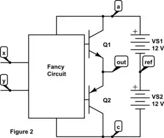

Now lets introduce an external reference voltage. It is still unknown so \$V_{ref}\$ can be used to represent it. The voltage at node b can be written: $$V_b= \Delta V_b+V_{ref}=A_vV_D+V_{ref}\tag{1}$$
So if \$V_{ref}\$ is unknown how is ithat we can know what it is. Well--- we get to choose it. That is the only way to "know" what the reference voltage is. To linearize Equation 1, \$V_{ref}\$ should be 0V. But what does that mean.
Remember the symmetry argument that for \$V_D=0V\$, \$V_b\$ is midway between \$V_a\$ and \$V_c\$. If a known mid point voltage source is created externally to the op-amp, then a voltmeter, placed from \$V_b\$ to the now known \$V_{ref}\$, will read 0V.
simulate this circuit
All that is left is to rename \$V_b\$ as \$V_{out}\$. So Equation 1 is now linear: $$V_{out}=A_vV_D$$
The linearization is important for measurements to make sense, and to tranfer meaningful voltages from one circuit to the next.
Additional point: The operational amplifier still has no reference. It does not "know" that there are two 12 volt sources. It does not "know" that the reference point exists. The reference is purely for our needs and sensibilities; for use where implementing circuitry using the operational amplifier in its various closed loop forms.

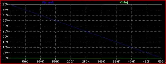

common mode dependence on supply
I simulated the following conditions where I am shifting supply, and I am seeing a change in the output. What is the reason for this? Has my reference shifted somehow?
Yes the reference is changed. When the input voltage \$V_D=0V\$,\$V_{out}\$ is at the midpoint voltage. The common mode input voltage will not change that (by design). You changed the reference from the midpoint so the measured output will reflect the reference change. The circuit is no longer linear.
The output would need to be centered around a DC bias point equal to (VDD-VGS(QP4)) with respect to VEE (negative supply). How does this DC voltage not show up at the output of opamp?
When the input voltage \$V_D=0V\$,\$V_{out}\$ is the midpoint voltage (also by design). And yes the voltage does appear at the output. Choosing the reference voltage to be equal to the midpoint as discussed above essentially treats that voltage value as zero volts.
Even single supply op-amps need to be reffered to a mid-point bias reference that some call a virtual ground. (It is different from the input virtual ground of an op-amp.) The FETs: \$Q_{P3},Q_{P4},Q_{N2}\$ in the OPs diagram are current sources that serve to remove dependance on any reference or supply rails.

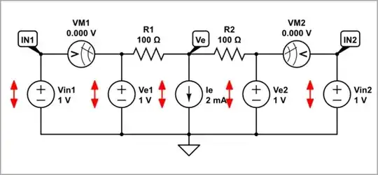

Equivalent circuit. I also made the equivalent electric circuit diagram just to follow the tradition but it turned out quite complicated. I put the two 100 ohm resistors because CircuitLab does not allow parallel connection of voltage sources. Maybe it is right because they are ideal and the resistors make them real. Anyway, this is another good inventive principle - "to do something upside down"... and to everyone's surprise, the result to be positive.
As you can see from the diagram, there are a total of five sources - four voltage and one current. The sources Ve1 and Ve2 are "clones" of the input sources Vin1 and Vin2. The schematic is conceptual and does not correspond exactly to the original one where only two voltage sources are really sources (producing power). Here they are all shown as true sources and therefore the directions of the currents do not match the original ones... but that does not really matter for understanding the idea.
In the middle of the circuit diagram, we see three sources - Ve1, Ve2 and Ie, in parallel. They are essential to our purpose... and especially the middle (reference) point with voltage Ve.
Exploring the differential pair
In common mode, the two emitter followers cooperate and together move the common "soft" ground. The two input voltages "do nothing"... the collector currents and accordingly, the output voltage Vout, do not change... there is no gain.
In differential mode, the two emitter followers oppose each other, each keeping the common ground stationary (trying to "move" it in the opposite direction) while the other tries to "move" it in its direction. The two input voltages have full control over the collector currents; they and accordingly, the output voltage Vout, vigorously change... there is high gain.
Conclusion
There is no permanently fixed ground at the midpoint between the emitters of the op amp's input differential stage because common mode requires it to follow the input voltages.
In differential mode, each of the input sources acts as a ground for the other.
The common mode removes the ground and differential mode creates it.
