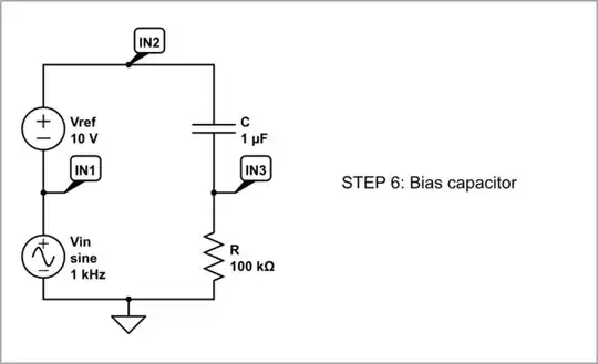

Bias capacitor
The most convenient devices for this purpose have turned out to be capacitors, and therefore historically they were the first to be used in AC amplifiers. To understand them, we can think of them as some kind of "rechargeable batteries". Here is the circuit operation...
simulate this circuit
CR - Fig.6
Vin = 0. Initially, the capacitor is charged through the resistor to Vref (like the rechargeable battery above). The current flows through Vref, C, R, ground and Vin (zero voltage). At the end of charging, Vc neutralizes Vref and the total voltage in the loop is zero; so the current stops flowing.
Vin > 0. During the positive half wave of Vin, only it acts in the loop. A current flows from Vin, Vref, C, R to ground. As a result, the positive Vin appears across R as an op-amp input voltage. The capacitor slightly charges.
Vin < 0. During the negative half wave of Vin, a current flows from Vin, ground, R, C and Vref. The negative Vin (below the ground) appears across R as an op-amp input voltage. The capacitor slightly discharges. It is interesting that the capacitor acts as a source producing the discharging current.
Thus, the voltage across the capacitor fluctuates slightly but its average value remains relatively constant. An advantage of the bias capacitor is that its voltage is always equal to Vref even when it changes over time for some reason.
