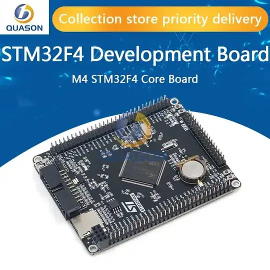

Prablem was on hardware, after resolder chip and some problem parts all works fine. In my case i use that board from Ali enter image description here
