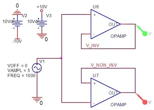

IMHO, the most elegant way to remember this is to think of the nullor voltage follower implementation:
The emitter follower:
The op-amp voltage buffer:
(They're all, obviously, AC/small-signal schematic representations only, hence the grounding of the op-amp power supplies.)
In this way, it's easier to remember that, just as a the op-amp voltage buffer, the emitter follower also uses shunt feedback at the output. Shunt feedback will make your closed-loop output impedance very low (but not well-defined, to do so you need at least 2 loops at the output, but that's more complicated).
The output impedance will very low at DC, but it will grow as the loop gain drops at high frequencies => inductive-like behavior at the output. The voltage buffer will suffer from the same, only that its closed-loop output impedance will be much lower than the emitter follower due to huge loop gain available at DC.
