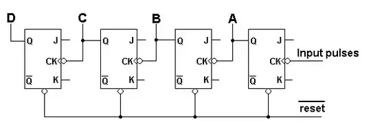

There are such things as asynchronous counters. Here's one: - enter image description here
It's also known as a ripple counter because when an input pulse arrives at the input (changing the state of the 1st flip-flop), that change of state takes a finite length of time to ripple thru to the remaining flip-flops. During that small but finite length of time the outputs ABCD will have an unpredictable transient value until the final flip-flop has settled.
If the outputs ABCD were then all fed through D type flip-flops and clocked together, some time after the settling period, this "better" version of ABCD will never "display" this transient behavior.

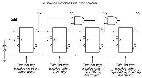

To avoid this engineers sometimes use synchrounous clock circuits. Sorry the input is from the left on this one and Q0 to Q3 map to ABC and D on the previous diagram: -
It's a little more complex but it's quicker and has fewer parts than compared to an asynch counter with a bunch of D types on the outputs.
  • Well, with counters it makes sense. But is there any application where flipflops are used without clocks ? or flipflops can never be used without clocks ? – avi Apr 11 '13 at 08:11
  • @avi The first example (async counter) doesn't have to be regarded as taking its input from a "clock". It could be pulses coming from a magnetic sensor looking to see how fast a shaft rotates. There would be a "master" clock on the system that "gates" the count every second but the "signal" going into the counter isn't necessarily a clock. The output from an analogue comparator could "clock" a "1" to the output of a D type and the output from another analogue comparator can reset the D type - this can be used to produce a signal derived from an analogue waveform - no clocks as such – Andy aka Apr 11 '13 at 08:41
  • I would regard the behavior of a ripple counter as being quantitatively rather than qualitatively different from that of the synchronous counter. The outputs of both counters will become invalid some period of time after a clock pulse arrives, and will become valid again some period of time after that. The synchronous counter will have a smaller window during which its outputs are invalid, but the window will be non-zero in any case. It's also worth noting that the maximum count speed with the counter as drawn will be limited by the counter length. One could avoid that limitation... – supercat Apr 11 '13 at 16:40
  • ...by having the carry chain start at e.g. the fourth bit, generating the "and" of the first three bits, and then having each bit only flip if the input from the carry chain was high, bit 2 was high, bit 1 was high, and bit 0 was high. Even if seven count pulses arrived in time required for a signal to propagate through the carry chain, that would be no problem since the carry chain would start propagating the carry when count xxx111...111000 was reached but its output wouldn't matter until the clock pulse after xxx111...111111 was reached. – supercat Apr 11 '13 at 16:46
  • Them ripple counters are simple but detested in the real world of digital circuits that I work in. Its good to know that they exist but it is highly unlikely that you will be allowed to use them for real projects. It can always be used in trivial exercises where their "asynchronous" nature is not an issue. – quantum231 Apr 20 '13 at 20:45
