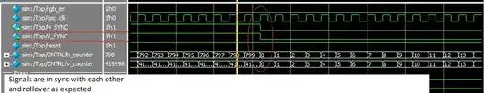

I have simulated the code in ModelSim (pictures included), and everything appears to look good save for one issue. When I count the amount of time steps that have occurred from the during the V-Sync display zone (when H-Sync is drawing) and divided it by the frequency of H-Sync, I get 479 pulses -- one short of the 480 lines I should be drawing. I don't understand where this could be coming from as I've check my timings many times, and I suspect that this may be a symptom of the problem, but I'm not sure.
The numbers I'm using to generate my numbers for timings is from Tiny VGA: tinyvga.com/vga-timing/640x480@60Hz Instead of counting lines for V_SYNC I am counting clock pulses, however, The numbers should be equivlent (ie. 2 800 count lines = 1600 pulses). I may change this behavior to line counting later.
Below is my code, and pictures of the timings from ModelSim.

H/V_SYNC and their respective counters w.r.t each other

    You really should include the actual waveforms measured with an oscilloscope in your question. I've found little reason to trust programmable logic simulations. – AngryEE Apr 10 '13 at 16:10
  • A general comment: in your code, you say you are making "state machines" for V_SYNC and H_SYNC, but it looks to me like those always blocks will just make combinational logic. The only state machine-ish thing you have currently is the counter. – mng Apr 10 '13 at 21:55
  • I agree. Comment has been edited. – Jon.H Apr 11 '13 at 00:58
