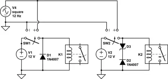

Let's do some comparison, shall we?
voltage plot current plot
Here we have voltage and current plots for a relay with a flyback diode, and a relay with a Z+D diode. The high Zener breakdown voltage (24 V) is meant to simulate a 24 V TVS diode. We can see that K2 "kicks back" a 24 V spike, which is limited by the Z+D pair (or TVS), but that the current through the coil drops very quickly. If the diode(s) are removed, the current, in the simulation, cuts off instantly and causes a voltage spike of ~20 TV! (You didn't have anything you cared about in that circuit, right?) By contrast, the current to K1 falls off much more slowly. In fact, if the cut-off current is 5 mA (or about 15% nominal voltage, which seems to be areasonable 'typical' value), K2 (Z+D) will open in ~1.7 ms and will be fully deenergized in just over 3 ms. By contrast, K1 (flyback) won't even open for over 8 ms.
Graphs are helpful, but this simulation provides an interactive demonstration of the difference between a flyback diode and a TVS/Z+D diode, as well as demonstrating the reverse voltage spike which occurs when a relay is deenergized. Start the simulation at high speed with the switch closed, wait for the relays to get close to their nominal current (~33 mA), then drop the simulation speed significantly and open the switch. Just as seen in the above graphs, the coil with the Z+D will jump instantly to ~24 V and will start to shed current quickly, matching the "cliff" that's visible in the above graphs, while the upper coil will lose current much more slowly and at a much lower ~600 mV.
As previously noted, this very small voltage is good for sensitive components downstream. However, it's worth noting that this also indicates that, while bigger is still better (from the perspective of draining the relay coil faster), almost any Zener or TVS, even with a relatively modest breakdown voltage, would be beneficial in terms of improving relay open time and reducing the chances of arcing. It is also worth noting that the current from a flyback diode alone follows a decaying-exponential falloff, which is the technical way of saying it drops more slowly over time. Since the opening current is likely to be relatively low compared to the nominal current, by the time the relay opens, the current will be dropping more slowly than initially. By comparison, the rate of current falloff with even a modest Zener / TVS is much closer to linear. (There is a slight slow-down as current approaches zero, but for the Z+D / TVS case, this doesn't have an appreciable effect until the current is already very small, on the order of microamps rather than milliamps.)
