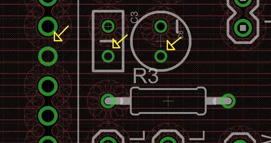

I am trying to make my first 4 layer PCB in Eagle and I have a question I cannot find the answer to regarding power planes and decoupling capacitors for ICs.
The PCB has an embedded Atmega328 operating at 16 Mhz and the power is +5V with a max current draw of 5A, but I don't expect rapid and big fluctuations as it is mostly just 1 or 2 LEDs turning on/off at a time. (If that matters.)
1. How should the power plane interact with the decoupling capacitors and the Vcc pins of my ICs?
When I first drew my power plane and labeled it to the +5V net, it made connections to all the vias on that net. And what I saw was that now my ICs are just straight connected to the power plane without being directly routed through the adjacent decoupling capacitors, like this:
I guess, I thought that the Vcc needed its own independent trace. And that the +5V for the Vcc would enter the trace at a single point, route past the 2 decoupling caps and to the Vcc pin, like this:
Instead, when I name the power plane to the +5V net, all three pins (Vcc for the IC, +5V side of C1, and +5V side of C4 are just all connected that would route the +5V past the decoupling caps to the Vcc pin. Is one way preferable over the other? Does it matter? The capacitors are still as close as possible to the Vcc pin of the IC. If they are all just connected to the common power plane, do they still function as intended or do they need to have the isolated trace that directs the current past the decoupling capacitors directly to the Vcc pin?
2. I'm only beginning to understand how ground loops work on a PCB. Do I need to be mindful of making a single point power distribution or does an arbitrarily poured power plane take care of this? Does it matter at 16Mhz? Will a power plane arbitrarily poured over the entire power plane layer work okay?

    Add [thermal relief](http://en.wikipedia.org/wiki/Thermal_relief). – Nick Alexeev Apr 09 '13 at 04:12
  • Thank you. I don't know why thermals weren't working when I took the screen capture. Is there a reason where you wouldn't want to use thermals and have the pour fully encompass the via? – EEstudent Apr 09 '13 at 05:09
If the IC's power and ground pins and the bypass capacitor power and ground pins are all directly connected to the appropriate planes, you don't need any tracks on the non-plane layers to make the power and ground connections.
The power and ground planes themselves make a fairly good bypass capacitor, in addition to any capacitors you add.

  • Wouldn't that defeat the bypassing? The majority of advice I have seen says both power and ground must be routed to the decoupling cap pads before any vias to power planes. – Jonathan Hale Oct 21 '22 at 23:41
You are absolutely correct. The bypass capacitors should be connected to the IC with the shortest possible traces, then to the power planes by SEPARATE traces and vias as close as possible to the capacitor pads. The goal here is to keep the switching currents from the IC out of the power planes that is the capacitor should be between the IC and the plane. I don't use Eagle, but in Altium I am able to accomplish this by adding a cutout in the power plane then route the power pins to the bypass capacitors with conventional traces. Here is a good guide from Texas Instruments that cover high speed layout and bypass capacitors.
http://www.ti.com.cn/cn/lit/an/scaa082/scaa082.pdf
ronk
  • I see a lot of advice connecting the IC's GND pin directly to a GND Plane Via, without bothering to route it through the decoupling cap's pad first. Wouldn't this increase impedance to ground / ground bounce? – Jonathan Hale Oct 21 '22 at 23:44
