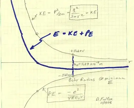

But in contrast to the quote above, below plot shows an energy of an electron versus its distance form the nucleus:
[Blue is curve shows the total energy]
The curve shows the absolute value of the total electron energy is getting closer to zero hence decreasing with distance from nucleolus.

As you see in the equation the total electron energy absolute value goes to zero by n where n increases with distance from the nucleus.

  • I'm pretty sure that's the energy needed to fully ionize the electron, or, alternately, the energy is negative (with respect to an electron at infinite distance). The [Wikipedia article the Bohr model](https://en.wikipedia.org/wiki/Bohr_model) shows the energy as _negative_ and _inversely proportional to radius_. So in absolute terms, conduction electrons have higher energy (less negative energy) than valance electrons. – TimWescott Jan 11 '23 at 20:14
