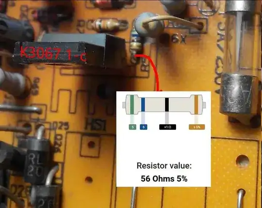

I don't see what it is. I think it is a 56 Ω resistor. Is that correct?

3Welcome! Unsolder and measure it? – winny Jan 09 '23 at 09:01
1I do it, but it is dead – Aliaksandr Shpak Jan 09 '23 at 09:50
3Bummer. 56 ohm would be my guess too. – winny Jan 09 '23 at 10:48
1Yes, correct. From the position (looks like a series gate resistor) probably a few more bad parts are on your board – Spehro Pefhany Jan 09 '23 at 11:17
I have replaced the resistor 56ohm and the K3067, but the power block is still dead... – Aliaksandr Shpak Jan 30 '23 at 11:43
